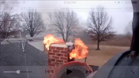

Hello
Good perspective!

No thanks ... Never happened to me, and I hope and pray it never does.
Take what I say with a grain of salt, but shouldn't some sort of fire retardant be sprayed from the intake rather than water poured down? And again, I'm a retardant, but my understanding is that firefighters are the only people allowed to break in your house without a warrant so they could do this with a chemical.

That is not how our guys here deal with chimney fires at all. I saw lots of potential problems with that approach

That is how it is done here dumping water down an over heated masonry structure can cause big problems.
Different departments do things differently . . . where I work they tend to err on the side of caution when it comes to protecting the property at large and have told me they will use the hose on a chimney fire if they feel it may be necessary to protect the home (realizing that it may cause damage to the chimney, but in the belief that it is better to be aggressive and extinguish the fire quickly).
Home town fire department is a little more patient, realizing that dumping water down a chimney could destroy it so they tend to spend a lot more time on the scene monitoring all floors of the home, typically using ABC dry chemical powder to attempt to put out the fire or a small amount of water to allow the steam conversion to extinguish the fire and typically they'll have to use a chain (with heavy weights) and heavy duty gloves since so often the chimney is plugged solid.

We use old truck tire chains made up to break the burning creosote loose.Also Gallon freezer bags filled with dry chemical powder are good for dropping down the chimney.Check the attic and walls for any extension use water as a last resort .In the video it looks like the chimney has a hole in the side so maybe they figured they couldn't do any more damage with the water.

That chimney has an integral cap. That's why there are holes in each side.
Many are designed with openings on 4 sides.

Wow, so glad they didn't do that for my chimney fires, but mine were out before the ladder truck came so they dumped down plastic bags full of a baking soda mix and did IR cameras to check for hot spots before leaving. Sooo glad they didn't run a hose of water down the chimney as that would have really made a mess inside the house.
Once again this makes me glad I found this site and changed my burning practices.

I don't know how long the FD in the video was on scene, but it doesn't seem like they are in too big of a hurry or are very careful with their fire extinguishing. Not a good idea to shoot cold water down that chimney like that, as stated earlier. I would have tried cutting off the air and using an extinguisher before anything else.

My first thought was to cut the air supply off. Like shutting the clean out door for starters!
There must've been a LOT of creosote in that chimney to burn that long, or something else must have been on fire and venting thru the chimney. Yikes!
