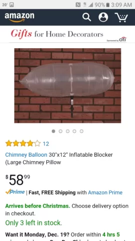

I'll bet you can imagine how much cold air is being sucked down the chimney into your home!. Pretty sure I could of hung a wind chime off my fireplace and listened to the music all winter! Other than install a insert or stove I don't know of a fix other than blocking off the flue. I couldn't hardly burn my fireplace if a cold air inversion set in.
yeah, it does leak a tiny bit. its has the typical steel plate damper. I held a candle up near the damper,, and it wasn't too bad
