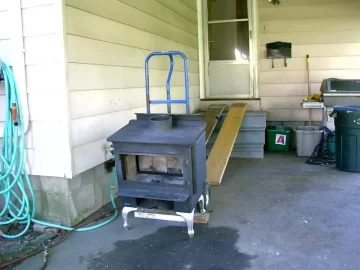

    I have used compressed air to clean my stove but I do it outside.
    One of the benefits of a small stove is you can wheel it around easily.
    I doubt there would be any buildup inside the burn tubes.
    I do get ash buildup in the dog house
    frequently. When I am doing the weekly ash clean out I vacuum out the dog house to
    remove the ashes ( making sure the stove is cold).
