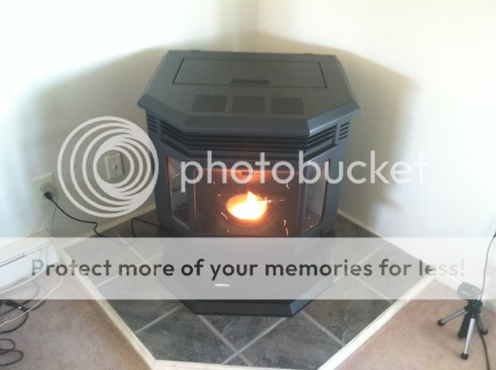

    Here is how I have my pellet stove setup. I custom built the hearth.

    Nice looking hearth Vinny :) Ummm, I don't see a surge protector for your stove?? That's really a must to protect your investment ;)

    You should think about putting that on a surge protector.

    Yes,surge protectors areva must when you have micro processors in your stove.any voltage spike can potentaly fry your motherboard(circuit board). Good eye!!!!

    Yes I know. I'm gonna grab one next time I goto home depot.
