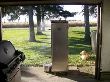

Personally - I like the add on option. I have built one for my homemade smoker for items like cheese. I don't have a pic of the add on box, but here is the smoker:

I don't understand why you can't do it on a regular smoker. Cold smoking is only lower temps. Right?
Most off the shelf smokers have difficulty generating smoke without also generating heat. Imagine on a 70 degree summer day what an increase of even 50 degrees would do to your smoked swiss.;sick
Huh. Thanks. I have never used a traditional smoker. Wouldn't know that.
