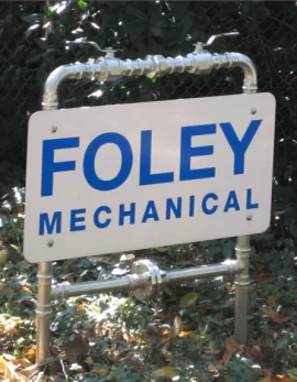

A jobsite sign from a contractor friend in the DC area.
