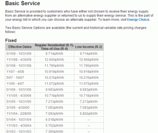

    See attached image for electric rates - I live in TAXachusettes

    Those are just the energy rates. You failed to post the other charges National Grid has too.
    The total cost per KWh is actually $0.147 right now when you add in the rest of the charges (distribution, transmission, etc.)

    True enough - MA has high rates for EVERYTHING. Makes me want to move.
