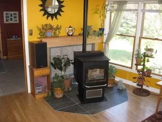

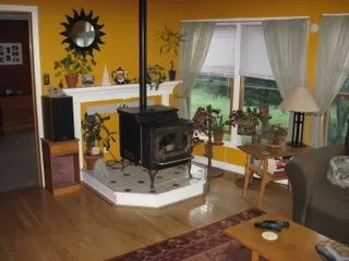

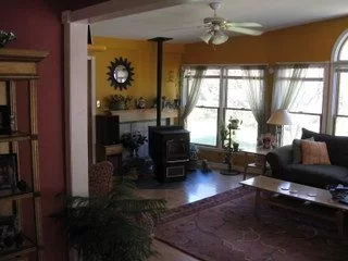

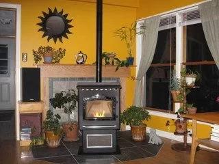

I siliconed at the nipple and taped the next seam up and no smoke smell. I've attached several photos of the new stove. The last one is of the old hearth and old Lopi Fox fire. You'll note the new stove isn't perfectly perpendicular to the mantle behind it. While it looks a little strange, I opted to do this in order to improve the air flow out into the rest of the house rather than having it point primarily into the living room like with my old Lopi. With the plants and decorations in place, I think it sort of "softens" the look as the stove blends into the corner a little better. Again, the odd location definitely improves the air flow out into my kitchen and back bedrooms. I also have two ceiling fans in the room which also aid in air movement. I think this alternate placement with really improve heat transfer.
The tiles on both the floor and the wall behind the stove are brand new. The mantle as well. As you can see from second to the last attached photo (IMG-0814), the Lopi sat on a raised wooden hearth with some cheap vinyl tile covering the plywood and the mantle was white painted pine with some tacky looking molding around it. The new mantle is solid red oak with a couple coats of satin poly applied to it.
I have to say I'm very happy with how it all turned out. And now that I think the smoke at start up problem is solved, I'm loving the Harman. Come winter, it'll now become my primary heat source and my #2 fuel oil boiler will be used almost exclusively for back-up and to preheat my domestic hot water (even that I'm considering getting away from). Thanks for the help everyone.
