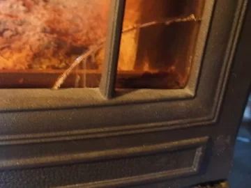

Hello all,
I had my stove installed three months ago and have been using it constantly for the last two month, and then last night the glass cracked. We always heat her up slowly and then with the exception of at night when we are sleeping, maintain a temp between 610 and 630. I have contacted the manufacture and sometime in the next 30 days I will have this fixed. As you can imagine, being the middle of winter this news was a bit tough to swallow.
My question is, is there a short term fix I can due myself so I can continue using my stove? Attached is a photo a shortly after it cracked. I am guessing that when the door expanded it it the glass.
Thanks,
Rich

I have the same stove and I wouldn't use it anymore until the glass was replaced unless you have the fire screen.
I suspect that many stove owners have run their stoves with cracked glass, depending upon how well it is still being retained in the door. Chimneysweeponline had this to say: "We've had customers continue to use their woodstoves for months with cracked viewing windows." (article here: (broken link removed to http://www.chimneysweeponline.com/howindow.htm))
For liability reasons, the manufacturers have to say NOT to burn w/ cracked glass.
Hopefully Quad will replace that on warranty -- some stove manufacturers (like PE) refuse to replace a simple crack. Cracks like this, they blame on the owner for pushing a piece into stove w/ the glass. However, this can, though infrequently, just happen from stress, usually the glass warping a bit (less frequently a door warp). My glass cracked when the stove was dead cold, in the summer, just sitting there one evening & popped! No detectable reason whatsoever!

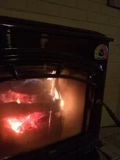

the crack you are showing I would still burn, but the OP has a crack that is it falls out or compromises more will expose almost half of the fire box.
