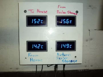

I bought some from Ebay a few years ago.Just installed them this fall so far so good.IIRC they were around $12.00 each with free shipping.Can be used in either F or C as you can see by the one picDigital temperature sensors for storage? Digital temperature sensors for storage?
Where do you get the 12v supply from?
I used a modified computer power supply. It cost me no money but alittle bit of my time. And the amp output is enough to power a whole wall of these temp readout monitors. I'll try to remember to take a picture when I get home.

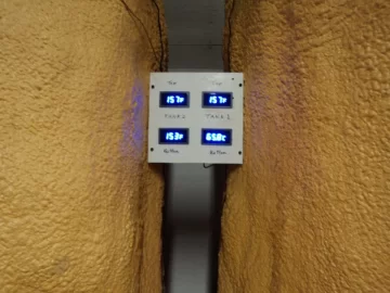

@Marshy and @Woodman1 here's my power supply and the back side of the readout panel. It's a bird's nest but I tried to tame it best I could. I bought a couple hundred feet of 18-2 wire to lengthen all the sensor probe wires that couldn't reach their destination.

These digital temp sensors are powered by a plug-in power supply that might be used with a laptop. It is visible under the display panel. Higher voltage and current output. This has been in service for several years without any issue.
How did you make the connection from the laptop power supply to everything else?
The power connection was made by cutting off the DC supply plug from the power supply, making sure which lead was +, and then wiring in parallel the power connection to each of the meters. The meters I had could be powered by 12-24VDC, and I just had to make sure the rating of the power supply was sufficient to supply all the meters. Higher voltage just resulted in a brighter display. Each meter has a separate temp sensor to the various measuring points. You can see the connection cables above the meter box.
