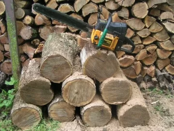

Your dimensions arent too big,makes it simple to do it yourself..Its pretty easy to rough out a block or short post/beam with freehand cuts. Find the log you want,a few inches longer than finished length- take a straight edge & a sharpie,draw a line on the end grain.Lay it on the ground,sight down the length,make a rip cut,holding feet steady & saw just outside your mark.

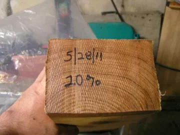

In the pic below I needed a short 3.5 x 6 white oak block recently.You can see the black lines on the log I drew,just below the saw.Less than 2 minutes to cut both sides.Trued up the other 2 with bandsaw fence.With practice,its easy to stay within 1/8" of any line you make.
