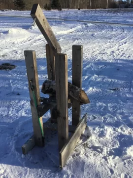

When a neighbor had two cords of well seasoned firewood he no longer needed the price was great but the wood was 18 inches. The longest I can use is 16 inches, 15 works better. The solution was this rig. Pack it tight with splits, stretch the bungee to the eye screw on the 2x4 to lock in pieces place and lop off the extra Into a bin. Pressure, wedging and some old small chain attached several places helps keep pieces
from rolling. It was built for one time use but now I set aside any wood that is too long until I get enough to make it worth getting it out.
