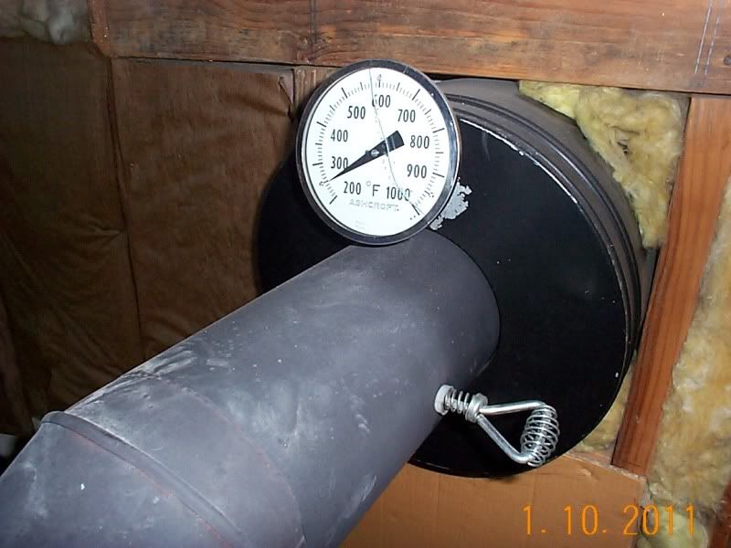

  21. mustash29
    mustash29
    Feb 6, 2012
    576
    312
    SE CT
    I've been using this for about 4 or 5 years now, works great. I got it from my work, the glass was cracked so it was taken out of service. 6" probe tip that sticks into a 1/4" hole.
    [​IMG]
  22. DanCorcoran
    DanCorcoran
    Jan 5, 2010
    2,202
    360
    Richmond, VA
    Yeah, the old "crack-the-glass" trick... :)
  23. Knots
    Knots
    Mar 13, 2013
    922
    409
    Alfred, Maine
    I recognize those from a certain SW CT factory's autoclaves.
    Measuring firebox temps is possible but may require specialty instrumentation.
