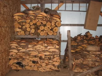

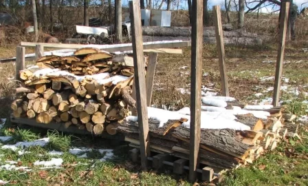

I can stack 180 splits in this rack.
It lasted me 10 days. The temps here are real mild.
