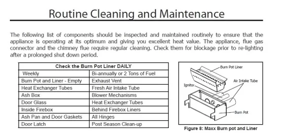

Don't blame it on the pellets What does the manual say about cleaning the stove internals? 6 years what were you thinking:eek: Read Page 9-11 carefully!
  • C-13846 Instruction Maxx-1 Domestic Owners Manual(1).pdf
I went with the Maxx partly because that's an insanely easy weekly list, and I always get busy right when something important is needed.
Plus in a few places it says "Bi-Annually" so every two years, right??!!?? LOL!!!

I guess my post was a little miss leading. I didn't mean that I hadn't done a thorough cleaning in six years. It meant that I was getting lazy and stretching it out. I do clean all those part you posted every time I empty the ash pan. the build up of ash was in behind the ash pot where the fire box baffle connects to. This is where the air goes through before entering the exhaust blower. I have never had a build up there before and didn't think to clean it the last time I took the baffle out. Now that this has happened I will be cleaning that area on a regular bases.

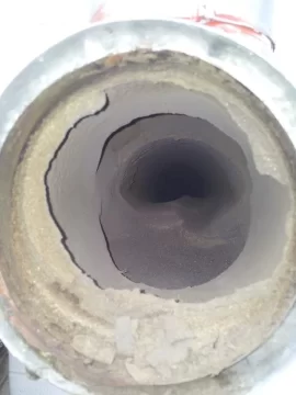

Ok , I understand now, don;t get lazy or things can go wrong. However , that being said I am guilty of not cleaning my flue after 40 bags, good thing my draft gauge picks a slight restriction up so i can detect this...Don't blame it on the pellets

hyfire,
is that view from outside or from inside?
That is i view from my outside Double T fitting, it lets me clean in both directions. vertical and horizontal. A very expensive fitting but well worth it in the end, or I would have no way to clean the horizontal. You are looking at the horizontal view, with the end cap removed.

Wow Hyfire that is pretty impressive. Is your vent horizontal straight out of the stove?

No, the stove has a normal tee fitting on the end, then 4 feet of vertical rise then a 90 bend then 2 feet horizontal pipe then the 4 way tee outside then another 6 feet of vertical rise..I get .05" w.c if the power fails, which is good enough draft to prevent problems... I am just suprised how the ash builds up on the horizontal pipe, and it does have a small slope upwards too..
Hyfire And that's just burning 40 bags? I don't feel so bad now Mine doesn't look that bad after two tons.
