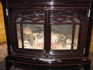

Second pic is explosive free downdrafting.

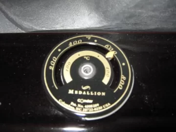

Third pic is proof.
Must have had an air leak in those doors.
