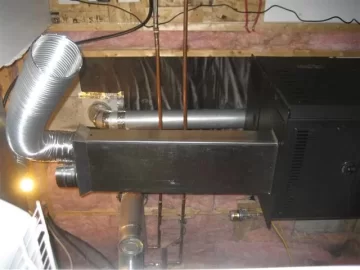

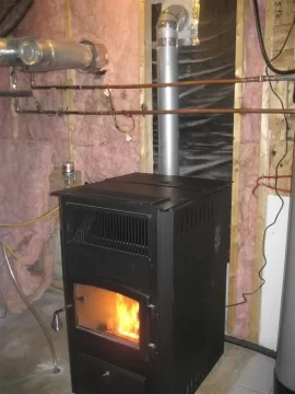

Hello everyone..
Here's some number after a good week-end for testing
this new install. It was -4F with windchill of -22F, house is 2450 SQFT.
builded in 2002.
The ECO-65 is in the furnace room with the door open so that the heat
can get out and take the stair and reach the first floor. I also have the oil furnace
blower running all the time.
A basement of 1020' and 1430' on first floor. I was able to keep the upstair
at 72F with the heater set at 2.., I heard the oil kick in once this morning for
a couple of minutes.
The basement which is made of 5 rooms has increased it's temperature by about
3-4 degrees compare to when I'm running Heat pump/Oil.
Burning Cubex and thermometer on top of glass door is showing 400F.

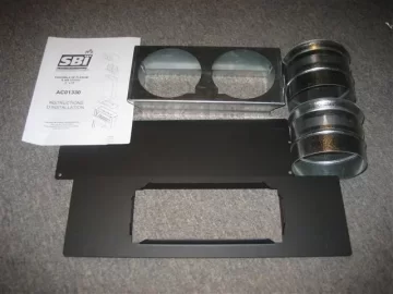

Currently waiting for the plenum Kit to possibly re-direct one register upstair
and one outside the furnace room in basement. Also waiting on a Skytec 3301
to use the HI/LO setting for hopefully a better efficiency....
Regards
