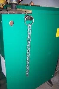

Other Eko owners have removed the turbulators completely and installed lengths of chain; for now I will stay with turbulators.

I was one of the guys that went with the chains but only for convenience. I tried both the turbs and the chains and logged no difference in performance so I say you're good to go with the OEM turbs. Glad to hear that someone else is as crazy as I am. I sheepishly confessed here that I also reduced the diameter of my brush with a bench grinder.

My conclusion on the turbulators in the Eko is that they weren't serious about making a good working turb from the start. If they had been serious they would have made something like a corkscrew that was wrapped around a mandrel with closer proximity to the walls of the tube instead of taking a ribbon of steel and putting a twist on it. Their shortcut actually made all that other claptrap they hung in there useless as well as having a turb that doesn't really do the job that it is intended to perform.

Chains or turbs work equally as well.
