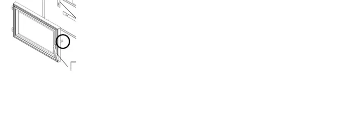

    Ok guys, I need some advice. The door handle on my pah is getting real loose when I close the door and lock it in. Only 2 years old. When I bought it, i was able to turn the handle 360 degrees around with the door close and locked. But it was tight enough that I didn't worry to much. Now, it has gotten loose and it worries me. I sent an email to Englander for help. Not sure what to do here. Seems like the door latch bar on the inside doesn't want to catch onto the stop any more because of expansion or wear. I can't bend it without the right equipment. You think I can add something to the bar to beef it up so it will catch the hinge plate to lock? Looking for some advise. I was thinking about wrapping around the bar with a metal coat hanger or some thick wire. Diagram attached.

    Are you sure the door is really closed tightly enough?? Have you done the dollar bill test lately? It's possible that the door gasket has compressed and now the latch is loose.

    Can you post real pictures of the problem? Hard to tell from the diagram. What did Englander say?

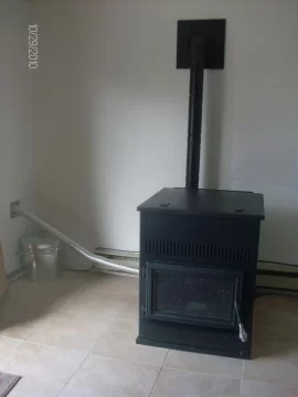

    heres a pic when it was first installed. I would say its a little more vertical now. but even though, I was able to turn the whole thing around when new.

    that's pretty close to where it should have been new, maybe a touch farther toward the right but not too far off, you say you could push it past even when it was new?
