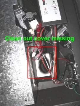

You may be missing the clean out cover
There is also a clean out slider that slides up in the Exhaust chamber
This is located behind the firebox you have to take the side panel off. I think it is the control board side.
I have seen them fall out in shipping or where an install lays the stove on the back to put things together
With it missing you can see right into the blower housing

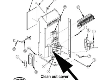

You also want to check the exhaust chamber clean out door is in place
I think I posted something on this in your other post.
The attachments are what im talking about
  • [Hearth.com] Enviro mini smoking

The clean out slider in the exhaust chamber is there - it just hangs from the top, right? I can sure see how it might slip off during shipping. The picture helped Rod - thank you.
And Rod, the clean out cover you mentioned - where would I find that? Or, if it is missing, where should it be?
Im cornfused?
your first line said it is there
and yes is just slides in from the top.
the second line you ask were it is?
They are the same thing
