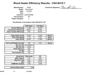

It's not on the qualified list that I can find. After a bit of a search I was able to dig up the EPA testing for the Warmheart, which is under the same listing as the BakeHeart. It performs well but it's overall HHV efficiency is 71.3% which is well below the 75% requirement.
If a stove like the Warmheart is ok then why not get a qualifying stove that has a big cooktop. Essentially, the only difference is that the Warmheart has a cooker lid.
