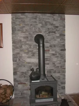

what you see behing my stove is"fake" rock - there is about a one inch gap btwn wall and sheetrock which then the fake rock is on the sheet rock - doesnt matter how hot the stove is the wall would never burn
  • Fake Stone

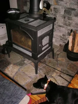

heres another pic a little closer
  • Fake Stone
