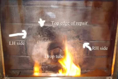

Just cleaned the Prodigy tonight (on the fly and needed the pliers to hang onto the burn pot)
Took a picture of the repaired fire back (brick)
In the piccy you can see the missing grooves in the brick look.
I marked the sides and the top with the arrow.
Used good old furnace and refractory cement.
Clean the fireback good and then trowel the stuff on in layers and build the worn fireback up to original thickness.

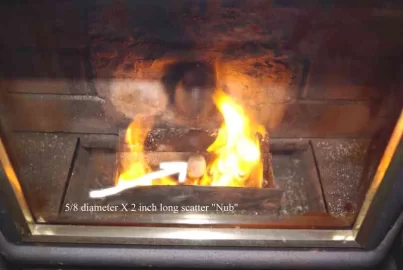

The other picture shows the "Scatter Nub" as I call it that I machined and installed with a countersunk 10-32 machine screw.
Tyhe "Nub" is positioned right in the direct path of the "Nut shells" as they slide down thefeed chute.
The Nub scatters the stuff over the grate more and stops it from piling up in the center.
I built something similar for the Advantage II T but it is a bar that spans the entire fire grate but does the same manuever.
The nut shells tend to be more granular from the current supplier and have to be scattered around to work best.
The ideal size is pieces about the size of your little finger nail. They feed great. The stove does on occasion make a lovely KAAAAARUNCH as the stuff goes between the auger flights and the tube end leaving the hopper.
Once the initial shock passes, you get used to it.
The little Prodigy just loves the shells.
