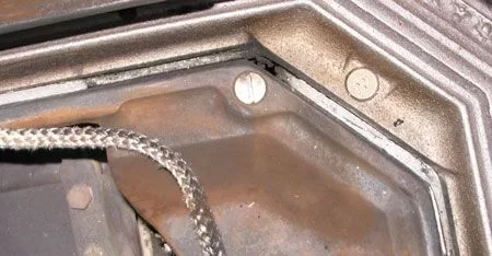

We love our Fireview, but tonight my significant other checked the lower gasket under the lid and found that there is cement missing under the gasket. The gasket is fine, but I assume that this might cause the issue that we were experiencing when we can periodically smell faint smoke that causes sinus irritation. Does anyone know what type of cement we would use to fix this? We don't have any problem controlling the fire.
