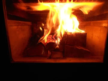

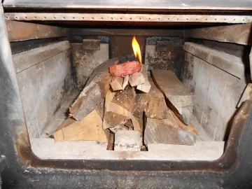

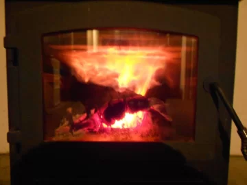

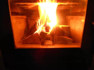

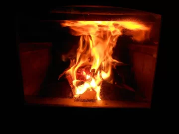

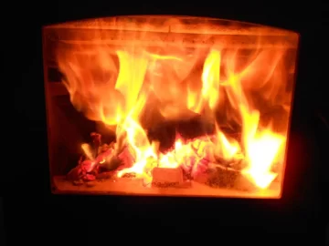

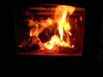

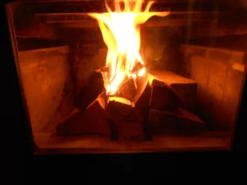

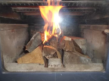

Normally I do a hybrid top-down start with some kindling on the supercedar chunk as I find doing that is faster getting things up to full tilt. But for the first fire when the stove is stone cold, when things were still in the 40's, I did a full top down (for fear of a down draft putting smoke in the house) Doing it this way is slower for me, but to the naked eye, completely smoke free (neighbor friendly if they still have clothes hanging out on the line).
Here's what things looked like for about the first hour or so.
I added a log to the center between the 6th and 7th pics.
Pic's weren't taken in equal time intervals, just when I thought about it or needed another beer.
Also, since the stove was completely cleaned out at the end of the burn season, I set the 2 outer base logs up on the lip that the 30 has next to the dog house air inlet so that they could get better air under them.
