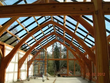

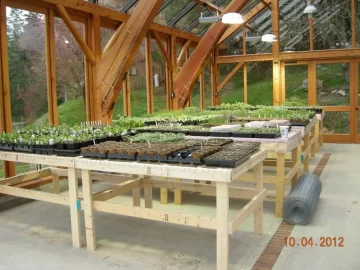

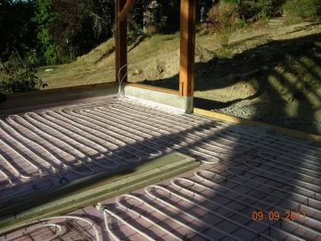

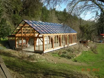

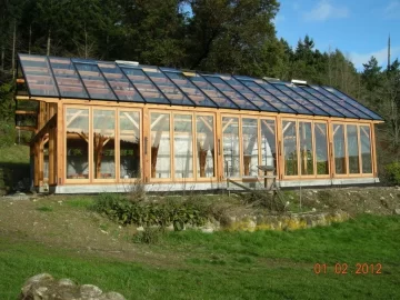

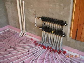

    Here are some pictures of the greenhouse - as you can see, R-value is close to zero! I had some trouble trying to shrink these pics for posting - almost finished, with boiler shed started.jpg first few benches.jpg hydronic loops before concrete.jpg hydronic manifold before concrete.jpg looking through the cruck frames.jpg side view almost finished.jpg please let me know if I've done it wrong! thanks
  10. We have not had any cold weather since the second week of January ,and very mild since then. If a full load is being burnt in 4 1/2 hours then storage will not help . If the longest burn time of 4 1/2 hours represents the time that boiler has run without idling then storage will help . This area of Canada , is know as " Lotusland " in the winter it is the mildest geographical region in the country .

    Well, context is everything. Now I see why you're getting the short burns. I have a 12 x 24' glass/aluminum greenhouse too, and I don't dare try to heat it in the winter, mainly because I like having a warm house and my supply of firewood has practical limitations. As to the creosote issue, you shouldn't be getting excessive amounts of creosote in the firebox if you're burning that thing all-out, balls to the wall, as you appear to be doing. Which brings me back to wood moisture content. A little water can cool and condense a lot of smoke before it has a chance to pass through the nozzle, but there are plenty of other possible causes if your wood is, in fact, dry. Have you checked with the mfg? The outdoor version of that boiler is fairly new, and perhaps they have some suggestions based on reports from other customers.

    Very nice. I especially like the idea of the stand-offs from the arches to the purlins. Are the arches from a local laminating shop, or was the whole thing custom built?

    Excessive creosote is caused by some combination of poorly seasoned firewood and extended periods of idling. I can't imagine that fir cut small and stacked for 2 years could be an issue. It would surprise me if anything is over 20%, based on how you described the processing of the wood. So that leaves idling. You didn't write about heating anything other than the greenhouse - is that the only load for the EB200? If so, it goes a long way toward answering why there's so much idling. The greenhouse radiant setup is probably not capable of pulling off even close to enough btus, and consequently the boiler is likely spinning lots of idling cycles. During all of this idling the fire smoulders, heating the air in and around the outdoor unit. Maybe it's even your primary load :(. If this is correct, then storage would essentially eliminate excess creosote. The boiler runs full-out to charge the storage, which then gets distributed to the load at a substantially reduced rate. Short-term, you should scrape the upper door on a regular basis, especially the 4 narrow, sloped surfaces closest to the outside. I use a 2 1/2" hyde paint scraper, which works great for that job. Also keep the bottom and top ledges free of large deposits. But don't bother removing any other creosote from the upper chamber walls. Burning small loads will greatly reduce idling - try to match the size of the fire to the current and upcoming heat load; which obviously includes having no fire at all whenever possible. The more you can do of that, the less idling and excess creosote you will get.

    I have to agree........That is one beautiful greenhouse. Other than that, everyone has said what needs to be looked into. It has been mentioned, but what method do you have for return protection?

    I counted 11 runs of pex on your manifold, and it looks like your manifold has flowmeters for each loop. Add up the gpm's for each loop, take that total x 500 x delta-T (manifold supply temp - manifold return temp), and that will give your btuH. Let us know what that number is. Since you are idling a lot, I will assume that number is much less than the 200,000 btuH rating of the EBW 200, which then clearly is the cause of the idling and the also the likely cause of the creosote buildup. My general rule of thumb is that a 200,000 btuH boiler will have average output over a burn of about 150,000 btuH.
