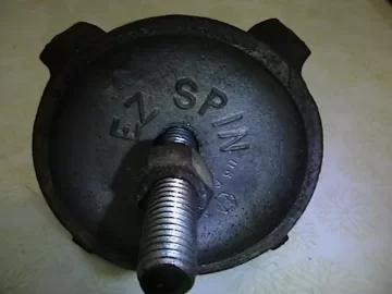

The EZ Spin is Fisher's own design that this company made the caps for. http://www.freepatentsonline.com/4037584.pdf
These are the early iron dampers that did not have the ring around the outside and measure 3 inches in diameter without the fins that stick out. Overall they are 3 1/2" with fins.
