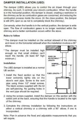

Hello,
I've just bought a flue damper, and was wondering at what height on the flue it should be installed at. I'm thinking about 6" above the flue collar. Any advice/suggestions would be great. Thanks.
