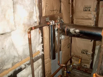

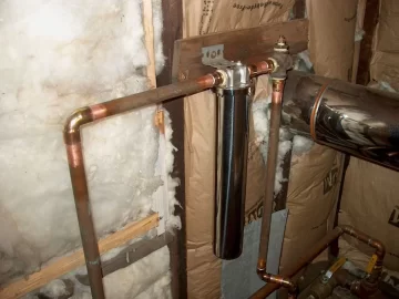

    Here are a couple shots of the filter installed. Couldn't find a LOW pressure gauge so I just left a tee in there to add one later if needed.[IMG] filter pics.jpg 2filterpic.jpg filter pics.jpg 2filterpic.jpg
