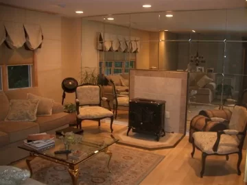

    I also live in Rockaway, didn't know there were more of us..:)
    I bought at and had my stove installed by
    firefoxenergy.com
    they are up in Lafayette and did a very professional job
    and were responsive to all of my questions. I do not know
    if they do installs for what they don't sell but you could always ask.
    Have a warm and toasty winter
