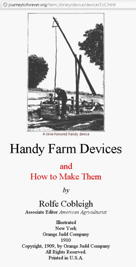

OK, lots of fancy gear available!
However, is there anything wrong with the olden technologies??
A catapult may be a bit too redneck, perhaps but what about this tried and true whatchamacallit device
(I still see it everywhere near farm fences here in the West but have been unable to find out what it is called)
One should either be able to lift several times one's own weight to a limited height or just about one's own weight while swinging it onto a higher deck or platform.
Henk

I suppose a fishwheel would be overkill. It would have to be hand- or step-cranked rather than river-driven. I actually think that Henk is onto something, given that you only need to make a 4' lift.
