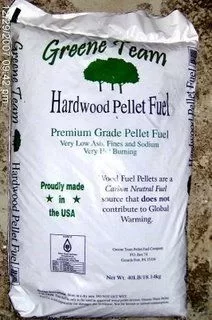

Edit:
Is this the pellets? Check attached photo.

Yup, that be them

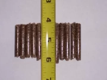

Here is a pic of what I took out of the hopper. This is after I have already broken some up.
Will take more if I find larger ones in the next bags.

So you would have to grab all the long ones and weigh them. 1% of 40 lbs. is .4 lbs total. If you get more than .4 lbs. there out of spec.
Otherwise you would have to do a lot of counting. and counting and counting.
I think 1% of 40lb is .4 of 1 lb, correct?
