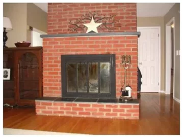

We never had a fireplace in our home or heated with wood before. The fireplace in our new house looks great but given the tax credit and the almost 2 cords of wood left by the previous owner we would like to actually get something useful out of it. We have a split-level ranch with about 1400 sqft upper level living space. The fireplace is pretty centrally located in the living room of the house but the floorplan is not really open. However, I would not mind supplementing some other heat to the bedrooms in the back. From our needs and the fireplace dimensions I figured a medium size insert should work well for us. I was reading as much as possible in this great resource here but some questions remain. I would greatly appreciate some input before “taking the plunge”. After visiting some local dealers we have to decide between the following inserts (prices all inclusive):

6. Our chimney is only about 13 ft tall since the fireplace is on the upper level and we have a low-rise roof. Do you think it will generate enough draft for the insert? We will certainly get a full liner. A little test fire in our fireplace seemed to draft ok although I needed to leave the glass doors open to give it enough air or it would start smoldering.

(Below should be a picture of our current fireplace.)
