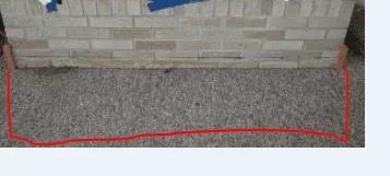

I am finally getting around to doing my tile extension in front of the hearth.
I have seen some pictures here, but I still want to do this perfectly!
The design I have in mind is (3) large 17" tiles surrounded by 3 rows of 2" square tiles on the sides/front. There will be bullnose on the backside.
I look everywhere (HD books, restaurants, and stores) and once I think I have an idea..I start to question what is right? I would like to do a wood picture frame around the tile/carpet transition. I'm just not sure if I need tack strip or can I place moulding tight and nail it down....etc..

My carpet "seems" to be fairly snug now...My questions/concern/dilema is can I lay my trim down over the carpet and nail it down or do I need to run tack strip and tuck it under the trim... Not a lot of books are helpful on this.....

I'm still a bit perplexed on how to do this "right" as I have found several examples/transition strips that do not use tack strip.
here is one example:
http://www.diynetwork.com/how-to/how-to-install-parquet-flooring/index.html#step4
here is another:
http://www.mdteam.com/products.php?category=798
My plan is to use micore and durrock (which I have)
I am going to use (3) 17" tiles with a border of 2 rows of 2" tiles.
My frustration is what trim to use and how to do it (use tack) -and then put down the trim and work inside, etc or just leave room for the trim and do that last etc?
I'm trying to avoid seeing an outside grout line and the md strip would cover the grout, or I suppose I could do the same with a router piece or does a shoe nailed on top of the trim look just as good?
sorry for the confusion...my house just doesn't look like all the ones in the books with perfect dimensions lol
