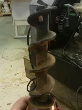

    check for build up on or in the auger tube. The build up will raise the auger and grind against the tube. Get it clean.
