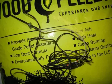

After all of the references to ESP's having only "red" wire and "black" wire sensors, I was surprised to see mine has "white" wires. Is this a 3rd type or did the wire color just get changed over the years?

Our stove has white at the beginning and connects the board with black.
If I remember correctly white and black wire ESPS are identical.

only the first few inches of the probe wires are white on some of the black esp probe.

That's the same ESP I have and mine also has the white. It is a black wire ESP. I'm pretty sure most PC45's are black wire ESP's. I ordered a back up ESP and it has the black with white leads at the probe also. Woodman's Parts has them for $70. I also got a red one for my P68 and it was $52.
