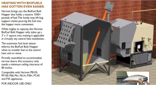

    Hi Scott
    Will it be an Automatic Feeder like the Harman Bulk Hopper?
    The Harman may work, just cut a hole in the hopper lid? Would that be too easy?
    HEATING WITH BIOFUELS
    HAS GOTTEN EVEN EASIER.
    Harman brings you the BioFuel Bulk
    Hopper that holds a massive 1500+
    pounds of fuel. The handy easy-lift bag
    support makes pouring the fuel into
    the hopper more convenient.
    While mighty in capacity, the Harman
    BioFuel Bulk Hopper only takes up a
    3' x 3' square area, making it applicable
    in virtually any central heat installation.
    The automatic fuel level sensor
    informs the BioFuel Bulk Hopper
    when to transfer fuel to the central
    heat unit or stove.
    Partially assembled to accommodate
    narrow doors, this accessory only
    needs a minimum ceiling clearance of
    80 inches.
    Compatible with Harman PB105,
    PF100, P68, P61, P61A, P38+, PC45
    and P43 appliances.
    FOR INDOOR USE ONLY.
    NOT FOR COAL
    B I O F U E L B U L K H O P P E R

    That harman thing looks like it has a long a$$ auger, I Would hate to have to pull that guy....I can just see all the stuff my customers would "Drop into" that that would clog up that 50 mile long auger lol

    I believe that Harman discontinued the bulk bin because it interfered with the hopper's ability to seal off air. I could be wrong but that is what I heard.

    just ordered one this friday past...still available

    I looked into building one myself too...parts expensive and there was bound to be bugs in the system as well. The harman unit is purpose built to keep vacuum in boiler hopper...a must for safety and operation. I have no idea how it works (suspect it is like an icemaker on the front of fridge). I even looked into purchasing harman parts but it turned out to be not cost effective. I will post pictures (or it didn't happen) LOL ...also it is paid for so it WILL happen
