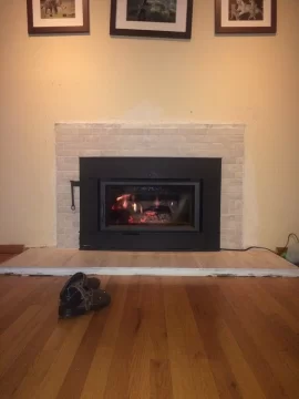

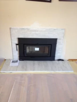

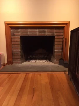

Here are some stills of the before and after.

...The brick surround on the wall has been covered with wonderboard, thinset, and the tiles. The fireplace lintel is about 10 inchest above the actual stove and about 3 inches above the stove's steel surround. I didn't want to use the extra-large backing plate for this stove, so I brought down the bottom edge of the wonderboard over the top such that the edge of the tile extends about 1" below the top edge of the stove's steel surround - behind it is just the wonderboard and behind that is just the open masonry firebox. So the first combustable material is about 18" above the stove, and about 14" to either side - so I am well beyond the Regency manual specs there. Out of curiosity I have been taking note of various temps with a surface thermometer. The dry wall above the center tiles on the top of the surround gets to around 87 degrees, and that's after a week of running the stove continuously. The wood floor in front of the hearth is about 90, with a room temp in the low 80's.
So here's the question - I know I am within the "letter of the law" on the current hearth, but is it worth the effort to go beyond the minimum at this point? If I were to do this again knowing what I know now I would have removed the 3-4" of hardwood and subfloor underneath the new heart extension and added layers to increase the R-value. Do I want to go in now and remove the wood and subfloor from underneath the hearth extension and replace it with greater R value material? This would be more difficult now, but certainly do-able.
Thoughts?
