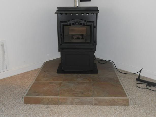

Below is the pad I built. Maybe $100 in materials and a little labor. Boss woman got to pick the tile to keep her happy. Extra room in front to put wet boots when the grandkids come visit this winter.

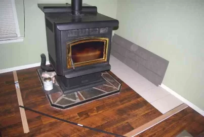

I cut out a section of carpet, then tiled straight to the subfloor. I have a Englander 25-PDV, does not require a hearth, only to be placed on a non-combustible floor, 6" clearance to combustible material. Went down to my local countertop/tile shop, and checked the "clearance" pile. Basically items returned from an overpurchase. Found 33 sq. ft. of 18x18" tile for $20. Some mortar, thinset, and a hour of my time. Total cost, somewhere around $50.

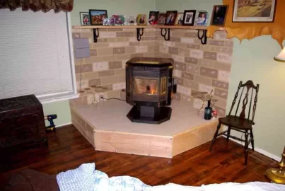

There are many cool ways to make a very mundane corner stove install come out magnificent.
Here are some piccy's of what we did.

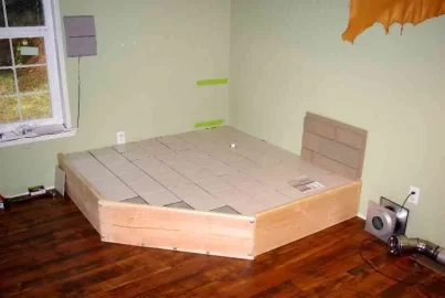

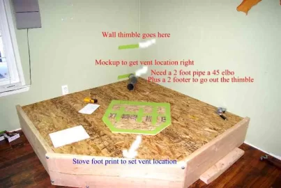

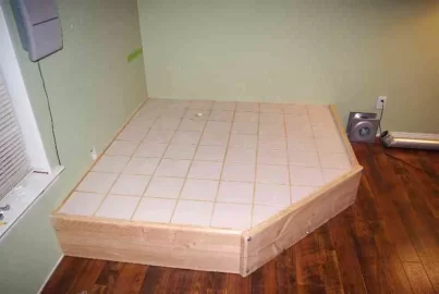

The old stove (earthstove WP50 pellet stove) with some tape and other stuff mocked up, getting ready to get at the project.
We added a raised hearth (about 12 inches high) covered the deck with 2 layers of OSB over the joists and then tiled the entire thing with 3/8 thick ceramic tile.

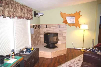

The wall still needed some serious help.
The cost of brick or plastic Faux brick was just out of the question.
Decided to do a Faux bricked "paint scheme" to get the look.
Then a "mantle" was added to top off the look.
The Mantle is 2X10 lumber with routed edges and the brackets are simple 1/4 X 1-1/2 steel flat bent in a right angle. The supports are good old used horse shoes I got from our own used shoe bucket in the barn.
The entire project cost only a few hundred dollars. The stove was $200 The wood I got from the Home depot and the tile came from the Habitat for Humanity store for $20
The paint cost was only a few dollars too.
The total was probably about $600 or so (No more ??) including the new vent pipe.
You can go as mild or as wild with a stove install and not cost all that much.
One picture shows the finished job with pictures on the mantle and the lived in look.
