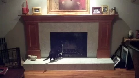

Here is a picture of the fireplace as it stands right now. The cat will be removed from the mantle before any work is done despite his complaints.
