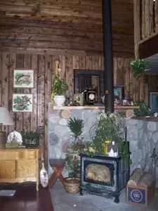

Today ( courtesy of Craigslist ) I bought a used Hearthstone Mansfield stove that has some damage to the secondary tubes and and baffle plate. Outside of the stove looks great and appears to have no cracked stones. Inside the second from the front air tube warped and fell out and the baffle plate has a hole in it. The rest appears o.k. with the exception of the upper stone frame which may be warped, but did not look too bad upon light inspection. I paid very little for the stove and aim to repair the damage. The stove has blue enamel and if the upper stone frame is warped enought to justify replacement or repair what is the most economical route to get this stone monster breathing fire again? Is it a really tough job to take the top stones off?
