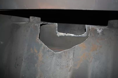

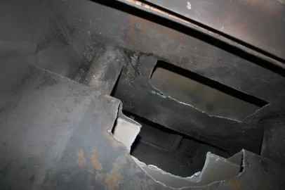

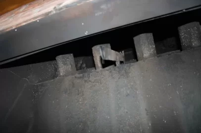

To get the 6 inch insulated Flex King Pro SS pipe down to the Clydesdale, I hired a welder to cut out two of the heat tubes, and cut out the damper. I had to bring the welder back to cut out more of the Heatform, because I discovered that I could not bend the SS Flex King Pro pipe enough to connect the pipe to the Clydesdale. This pipe is not as flexible as one might like it to be.
As you know, the Heatform has ridges, and its the ridges that caused me a lot of work fitting the stop plates - which my welder then welded onto the Heatform. I figured that I would never need to get into to the area of the now removed damper, so I sealed it off permanently. Below are a few examples of photos from the "cut and weld" job.
