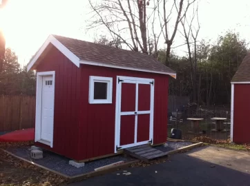

    I built a 8x12 shed this past summer and put it up on patio blocks above a gravel base. Haven't had any problems with critters, fortunately.
    I used PT 2x6s for the floor and t1-11 for the siding and scored a free pre-hung door and windows from my brother-in-law, but it still cost me about $1,500 for materials. It way better built than the Home Depot sheds though, which would have cost about the same.
    Here's a picture of it 95 percent complete.

    Quite the fancy shed stegman!!! Very nice!

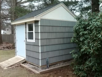

    Hey Stegman
    Glad to see our Dueling sheds are done! Congrats! I like those Stones and landscape lumber, very professional looking!!
    So what else are you going to do to finish it?
    Mine is all primed but have to paint it in the spring.

    Hey Don.
    That looks pretty sweet. I like the gray. Are you going to paint it roughly the same color? And is that door of yours looks sweet. It appears wider than a standard size door.
    I don't have much left to do - just the gable soffits and corner trim and the big window on the other end - another freebie from my brother-in-law. I also have to lay some plywood down over the cross-ties to get some additional storage space up underneath the rafters. Probably another weekend or two of work. I have to say, we got real lucky with the weather. I was worried that I wouldn't get as far along as I did.

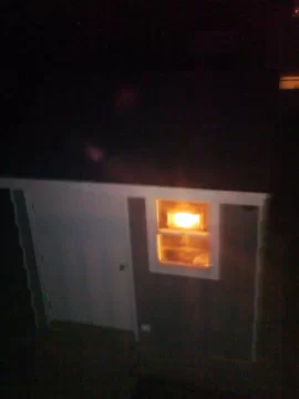

    I skipped the gable vents and put in soffit vents and a ridge vent. It holds the heat much better this way when heating in the winter.Also, I skipped the collar ties and went with an LVL cathedral ceiling. Then added an open loft that can sleep 2 and watch the TV. LOL
    I may paint it the light grayish blue to match the house with white trim in the spring. Then put in the rope light under the soffit and hookup to the light switch installed in the house.
