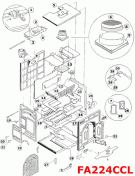

    Well, if you can make sense of it the way I pirated it, here's what's to be found in the link that Craig posted. I'll try pasting the parts list, then attaching the exploded diagram:
    #01 - Torsion Bar Clip Item# 9533
    #02 - Damper Item# 9675
    #03 - By-Pass Gate Side Support Item# 9662
    #04 - By-pass Gate Crank Assembly Item# 9579
    #05 - Catalytic Probe Thermometer Item# 9555
    #06 - Catalytic Combustor Item# 9571
    #07 - Glass gasket Item# 10140
    #08 - Interam Gasket Item# 9583
    #09 - Combustor Chamber Item# 9641
    #10 - Baffle Item# 9643
    #11 - Right Side Grate Item# 9647
    #12 - Grate Back Item# 9666
    #13 - Front Grate Item# 9665
    #14 - Left Side Grate Item# 9648
    #16 - Shaker Grate Cover Item# 9670
    #17 - Rocker Grate Item# 9645
    #18 - Fixed Grate Item# 9576
    #19 - Brass Dial (small) Item# 9663
    #20 - Brass Handle Item# 9427
    #21 - Brass Dial (large) Item# 9632
    #22 - Shaker Grate Cap Assembly Item# 9637
    #23 - Side Half Wall Item# 9633
    #25 - Glass Frame Item# 9716
    #26 - Glass Pane Item# 9694
    #27 - 6" Leg Item# 9573
    #29 - Door Latch Assembly Item# 9686
    #30 - Spring Item# 9638
    CDW Gasket Kit - Vermont Castings Brand Item# 9596
    Black Swan Brand Dutchwest Gasket Kit Item# 9575

    Fossil--thanks--got the image and the parts very readable. Looks like the one--down to the pie wedge doors with the little rectangular windows and the rocker grates. Interesting in the parts list:
    Will have to see if DW India is the Black Swan version of CDW Vermont Castings.
    Thanks for the info. Very helpful.
