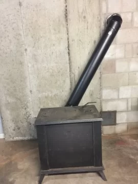

Hello all,
I'm New here. We recently acquired this wood stove from a relative and for insurance purposes we need to know a serial number/model. Can anyone help me out? There's no markings or name plate on the stove. I believe it was purchased in the 80's. Any help will be greatly appreciated! Thanks!
Help me identify my wood stove!
Bad news but you won't be finding anything. Back in the 70s and 80s hundreds of local shops were welding up stoves. Like that one. When the EPA regulations came along they all got out of the stove making business. But that one appears too meet generic clearance requirements of 36" from any combustible material.
Paging @pen looks like a Tempwood?
