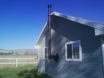

    Post a picture of the entire outdoor chimney. There's a way to fix this I suspect, but it will help to see the whole shebang first.
  9. begreen Super Moderator
    joined: Nov 18, 2005
    36,118 posts
    South Puget Sound, WA
    Yup, that helps, though it's what I was concerned about. There are no wall braces for the length of the run. The fool person that installed this was cutting every corner he could. Give me a little time to digest the options here.

    Wow that's a scary looking install ! Is that an actual through the wall kit or is it home made ?

    The through wall bits look just like the duratech Thimble/collar kit does. I'm pretty sure it's a factory piece. When I take the chimney down to re-brace it from the bottom up I might just take it apart to check it :rolleyes:

    It looks like the chimney is going to need a rebuild anyhow. If it still is in good condition, you could reuse the current parts if you stick with 6" class A DuraVent pipe. For the rebuild, the goal would be to get it properly supported and anchored and a bit taller. I would take the current horizontal piece in the tee and replace it with a shorter snout piece, like 12-18". Then mount the tee on a proper support bracket, go up to just below the attic entrance, then offset with 30º elbows and a short connector to clear the soffit. Lock the elbows with side plates. Secure the pipe to the building above the tee, just below the lower elbow and at the soffit. Use that long horiz. piece up top to extend the flue height if necessary.
    The BK Princess would work for your place. It takes 6" pipe. But it's somewhat off the original request for a strongly radiant stove.

    I think I understand what you're suggesting. Something like this? As far as I can tell all of the existing pipe is still in good condition, so I should be able to reuse it. Cold weather is upon us here, so I'll try to work on it this week. However, I do like the straight shot with the current setup, as it's easy to inspect and clean. With the angled part, if the top and bottom look good, can I assUme the angled bit is clean as well? And the only way to clean it is to disassemble it?

    Yes, that is the idea. You will still be able to sweep it, but won't be able to visually check it looking up the pipe. That's not a big deal really. Burn good dry wood in a modern EPA stove and cleaning will only be a couple times a season, if that.

    Ok, maybe a stupid question. It appears that I have DVL double wall pipe outside. The only 30* bends I can find are triple wall, and cost $320 :eek:
    http://www.dynamitebuys.com/store/cart.php?m=product_detail&p=1090
    Can double and triple wall pipe be mixed? Of course, it may not happen this year after an unexpected $800 vet bill for a sick horse :rolleyes:
  22. begreen Super Moderator
    36,118 posts
    DVL outside? I was suspicious of that closeup shot of the Tee, but that clinches it. DVL is interior connector pipe only. Whoever piped this chimney messed up seriously. Figure on redoing the entire outdoors chimney if this is the case.
