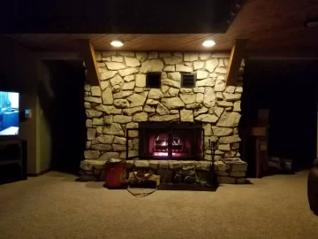

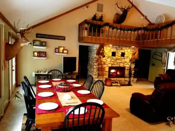

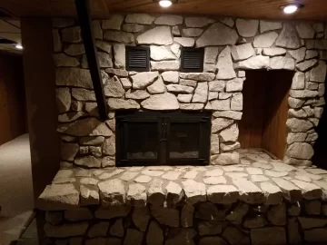

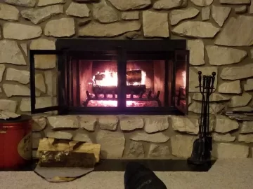

Pics for reference.
First pic is fireplace in basement, the rest are upstairs living room fireplace.
20180116_200602.jpg 20171223_095155.jpg 20171121_190429.jpg 20171121_185338.jpg

My fireplace is a zero clearance unit. The metal tag tells me its a Superior. Model is stamped as 38 on the metal tag. I could find nothing on model 38 from Superior.
I did however figure out that i am nearly certain this is a later model Superior Heatform. It is a bit different than the ones i have seen on here, but same concept.

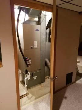

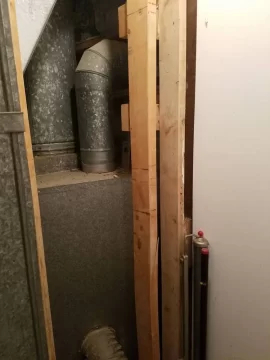

I have no way to access the one that needs replaced or retrofitted with an insert, but the one in basement is identical and i got a couple pics of the back, sorry the air unit is in the way.
