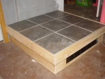

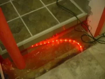

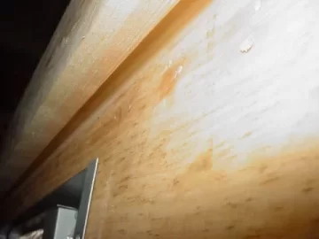

Hello
Here are some ideas for you from what I did!
1.
I got my sliding mitre saw out and built a raised hearth with and overhang in which I made a grove and put in red rope light for effect!
2.
I connected my wood pellet stove to my chimney and just put in a stainless chimney for my oil boiler!
That way the wood pellet stove can be in the middle of my house using the center chimney and it heats the whole house quite easily!
Good Luck
See pics below:
PS. That black grill is a 900 watt 220 volt electric KickSpace heater to warm my feet when the stove is down for cleaning!!
