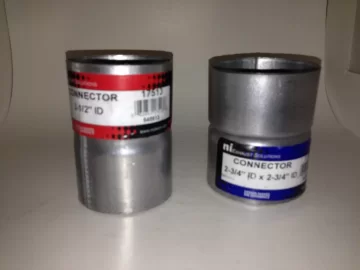

Go to Pep Boys and purchase 2 Nickerson Industries auto exhaust adapter pipes:
1. 2-3/4" ID x 2-3/4" ID Connector Part # 17586
2. 2-1/2" ID x 2-1/2" ID Connector Part # 17513
Put the 2nd one in the stove flange and slide the 1st one over it and clamp the metal flex pipe on the 1st one. I can also bolt the 2 adapters above together with a self drilling screw and put RTV in the joint for a good seal. There is not a real need to silicone the 2nd adapter to the stove flange so it can be taken off for servicing the stove easily.

See pics of muffler adapters below. Click to Enlarge:
  • Hooking Up and OAK to a Magnum Baby CountrySide? - Flex to 3" stove flange? ?

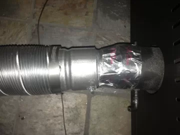

I tried the 3rd option, my own suggestion and it worked great! See Pic below!
Using RTV and self drilling screws I connected the two muffler adapters together for a nice strong tight seal, then I clamped the 3" Selkirk metal flex hose to the larger adapter for a nice tight fit. Then I slid the smaller adapter into the magnum stove flange and used foil tape to seal it real nice. Now to service the stove just undo the foil tape and the exhaust adapter just pulls right out! Simple and easy to install and use!
