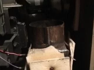

    Ahhhh, that makes sense. I do have the adapter to hook it up to the stove. It does look like the previous owner just put the the stove pipe right over the exhaust exit as it does stick up like 4 inches. Is this okay to do, or should I use the adapter? Thanks for all the advice!

    The proper way to connect the 4" pellet vent pipe to the stove is to use an appliance adapter, as Brewer states above. If the stove exhaust is 4", then just a 4" appliance adapter is needed.
    If the stove had a 3" exhaust, there are 3" --> 4" appliance adapter available too, although you didn't specify what brand of pipe you're using on the back of the stove.

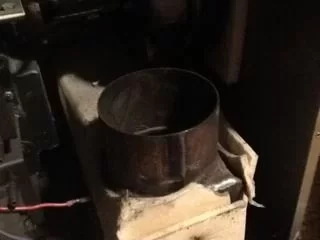

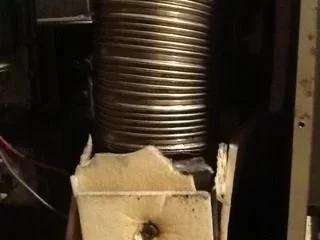

    Here is what I am dealing with. The first picture shows the stainless steel pipe that fits snugly over the exhaust outlet. The next two show the exhaust outlet. The adapter does not fit in or on this exhaust outlet. The drawings in the manual I was given show what look like the pipe fitting over this exhaust outlet as shown in the first picture. The exhaust outlet opening measures 3 7/8 inches.

    It appears that the flex pipe in first pic is single wall, is that approved for pellet stove use?

    It came with the pellet stove and the guy was using it just like this. I assume its okay.
    Yes I am going from 4 inch to 6 inch stainless steel chimney liner hence the 4 to 6 inch converter.
